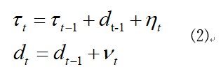

where log(I(t))=tau(t) +c(t), tau(t) is the unobserved trend, following RW(2) process:

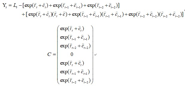

I use multi dimensional taylor expansion to handle non-linear multi-variable equation (1):

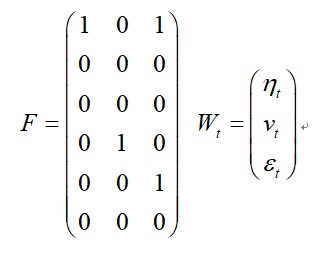

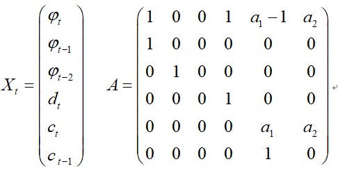

Then,I get a state space represtion of (1)-(4):
Where
W(t) follow normal distribution with zero mean.and covariance matrix R :

a. Your F matrix isn't quite correct. With d_t entering the tau equation, substituting out for it gives you both eta(t) and nu(t) components for tau.
b. You don't actually ever need the tau and c separately for the expansion, do you? They always occur as tau+c---for an initial guess of that you can just do a straight @DISAGGREGATE.

Thanks. I ignore a detail. If eq(2a) modified to tau(t)=tau(t-1)+d(t-1)+eta(t), is the F matrix correct?
Hardmann
Posts: 7823
Re: Question on Log-linear Model
Yes, with the dates corrected that way.

For expansions, if we expand directly on log I(t0) instead of tau (t0) and C (t0) separately, I am not sure whether the results are different. If there is no difference, the expansion on log I(t0) is concise and effective.

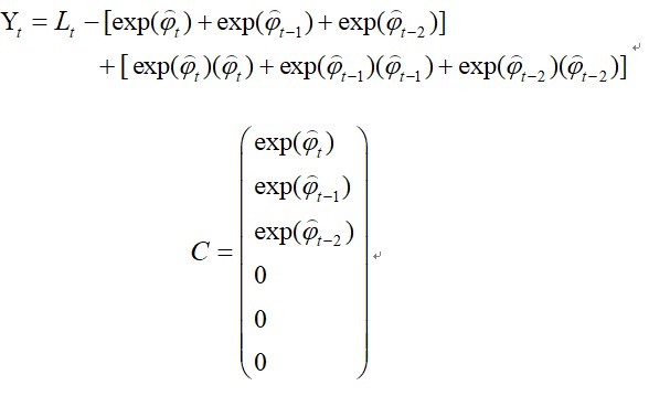

a. Only treat tau and c as one during expansion(which lead to same result as separate one) and following the setting of X(t),A,F,W,Y(t),C above. Finally, do some initial value guessing that I don't figure out yet.
b. Set phi(t)=tau(t)+c(t),Since
So I omit tau(t),set
Finally, set intial value as log(observed data* a weight that corresponding to MAINTAIN option).(Since there is only one variable in iteration process.)

You can rewrite the model, but the original point is that the non-linearity applies only to the sum of tau and c, so the derivatives in the linearization depend only upon the sum of tau and c, thus you don't actually need an initial guess for tau-tilde and c-tilde but just their sum. Once you've done one iteration, your model is generating tau-tilde and c-tilde (and thus their sum).

I tried to imitate @Disaggregate code to solve this model , since tau-tilde and c-tilde have different stationary properties,so there is a need to set g matrix in DLM.So how to set a g matrix that match corresponding state?
