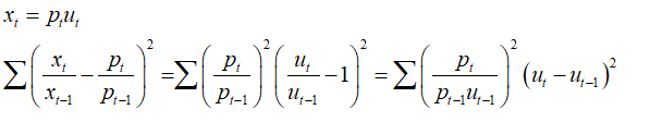

If you rearrange the objective function:
ekf model.png (6.02 KiB) Viewed 82353 times
one way to do an EKF is to take the previous u_{t-1} in the multiplier term, which would make the multiplier known on a particular iteration.

I do not know to specify state equation about it. If I take the previous u_{t-1} in the multiplier term, should the state varible redefine u_{t}-u_{t-1} or remain u_(t)
Could you give me further suggestion?
Best regard
Re: EKF for benchmarking of Growth rates preservation (GRP)
You're going to need to augment the state vector anyway in order to do a multiperiod measurement equation, so you can use u{t}, u{t-1},...,.u{t-q}. You have to decide what type of time series model you want for those. RW is the simplest.
Doesn't that just turn into the proportional Denton model with a time-varying factor multiplying the (u{t}-u{t-1})^2?
