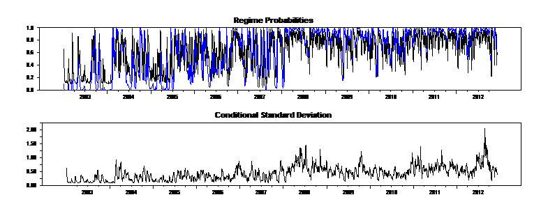

I really appreciate your kind replies and I'm so sorry for asking so many questions.
Here is the graph.
I would be grateful if I could possibly have your final word about it. Doesn't it mimic probabilities again?
figure 5.png (17.71 KiB) Viewed 89521 times
Re: Gray JFE 1996 Markov Switching GARCH model
First of all, isn't that effectively the same graph as in the paper? But no, compare the 1980-1982 range. The probabilities are relatively flat and the standard deviations are very spiky. If you compare the graph with the switching by non-GARCH variances, where the probabilities are flat, so are the standard deviations.

9.  B12                           0.229441167  0.070668669      3.24672  0.00116744
10. B22                           0.246944292  0.038749720      6.37280  0.00000000
11. P(1,1)                        0.960576407  0.013708449     70.07185  0.00000000
12. P(1,2)                        0.075710440  0.020554312      3.68343  0.00023011
MAXIMIZE - Estimation by BFGS
NO CONVERGENCE IN 12 ITERATIONS
LAST CRITERION WAS  0.0000000
SUBITERATIONS LIMIT EXCEEDED.
ESTIMATION POSSIBLY HAS STALLED OR MACHINE ROUNDOFF IS MAKING FURTHER PROGRESS DIFFICULT
TRY HIGHER SUBITERATIONS LIMIT, TIGHTER CVCRIT, DIFFERENT SETTING FOR EXACTLINE OR ALPHA ON NLPAR
RESTARTING ESTIMATION FROM LAST ESTIMATES OR DIFFERENT INITIAL GUESSES MIGHT ALSO WORK
Daily(5) Data From 2003:01:03 To 2012:12:06
Usable Observations                      2590
Function Value                     -1018.0690
    Variable                        Coeff      Std Error      T-Stat      Signif
1.  A01                          -0.013393998  0.000380707    -35.18194  0.00000000
2.  A02                           0.045332574  0.002076028     21.83620  0.00000000
3.  A11                          -1.097700039  0.005548809   -197.82625  0.00000000
4.  A12                          -0.303118795  0.027167144    -11.15755  0.00000000
5.  B01                          -0.001011178  0.000002767   -365.49626  0.00000000
6.  B11                           0.059900700  0.000807929     74.14101  0.00000000
7.  B21                           0.609069171  0.000384612   1583.59479  0.00000000
8.  B02                           0.019938741  0.000145776    136.77666  0.00000000
9.  B12                           0.045280994  0.000174983    258.77336  0.00000000
10. B22                           1.870801841  0.029521412     63.37101  0.00000000
11. P(1,1)                        0.820696725  0.000355251   2310.18726  0.00000000
12. P(1,2)                        0.723588475  0.006872191    105.29226  0.00000000
And here is ex ante and smoothed probabilities:
figure 5.png (28.08 KiB) Viewed 89500 times
Here is the code:
You realize the Gray was analyzing US interest rates and his model was chosen for that. I have no idea what your series is, but it has very different dynamics than Gray's. Your results suggest that your mean model is wrong---you're showing signs of overdifferencing.
There's absolutely nothing wrong with a small P(1,2), that means P(2,2) is fairly large, so both regimes are persistent, which isn't that unusual. However, it looks like a MS model is overkill. There appears to be a structural break about at the midpoint of your sample, and the MS is simply picking that up.

Following figure shows ex ante and smoothed probabilities. Introduction of exchange rate futures took place on April 23, 1990 . Can one say that this event has increased the volatility of market? Or it has had a destabilizing effect on the market?
Can I have this figure to be shaded after this time? How can I have LB statistic for squared residuals of Regime-switching GARCH?
If something happened in April 1990 and your data set starts in 2003, how do you think that your results will show anything?

I'm really sorry. The event took place in April, 2008.
If you have a particular date of interest, why are you doing a MS model? That's completely wrong for that. Just concentrate on the differences in the model before and after the policy change.
