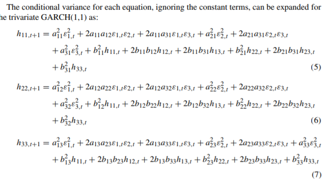

Is it possible to get the conditional variance equation in a trivariate BEKK model in RATS
conditional variance equation.PNG (74.36 KiB) Viewed 69706 times
Posts: 7825
Re: VAR(1)-BEKK-GARCH(1,1) Model
It's possible. In practice, it's a waste of paper.
https://estima.com/forum/viewtopic.php? ... 46&p=15694

Dear Tom.
https://www.sciencedirect.com/science/a ... 8320303054, authors estimate Partial co-volatility spillovers for a VAR(1)-DBEKK(1,1) model. They estimate it as A(i,i)*A(j,j)*e(j,t-1) where e(j,t-1) is the mean return shock. I know how to get A but what about the mean return shock e(j,t-1)? How can I get it when I estimate a DBEKK model?
