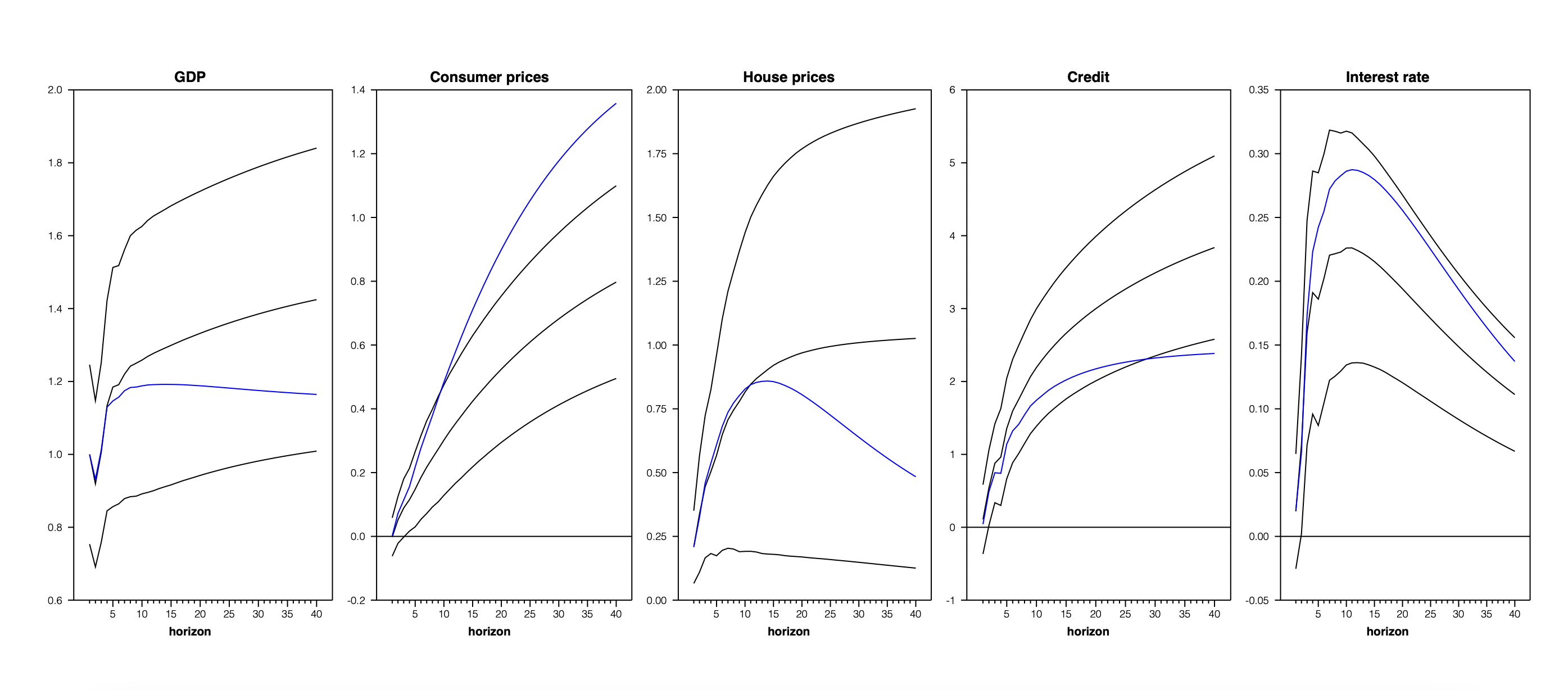

In the last part of the code, I insert in one graph two impulse response functions and I get this graph, which is not so clear. I run this code and I receive the following graph. I would like to have two different colors for the IRFs and one color for the confidence bands. Thank you in advance!

You are using 1 (i.e. black) for upp, low and respons85, while 2 (i.e. blue) for respons76. I would think that using respons85 and respons76 should be something different from each other and from upp and low.
