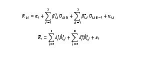

Hi Tom, thank you for the reply. In the paper, the estimated factors are the new factors, similar to the fama-freach 3 factors. The authors first use the time-series regressions to obtain the factor exposures to the estimated factors and then use the cross-section regressions to obtain the factor risk premiums.
I studied the example code posted by you; I found the code is for panel data. What if the sample data are organized in time series format? What code we should use? Second the example code seems only for the cross-sectional regressions. Could you please advise us how to conduct the time series regressions in the first stage? Please, kindly correct me if my understanding is incorrect. And I am looking forward to hearing from you. Once again, thank you for your valuable advice.

TomDoan wrote:That's a relatively straightforward state-space model. How far have you gotten?
Hi Tom, following He's paper, I am trying to estimate the following model. By construction, the three proposed risk factors should be orthogonal to each other. But the correlation is among the three extracted factors is not close to zero, instead of being quite high, e.g. -0.51 for market return factor and change in investment opportunity set factor. I am not sure what caused this high correlation. Could you please kindly share your advice on what i might did wrong? Many Thanks
