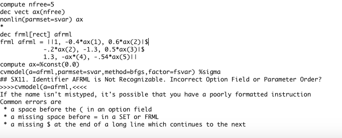

Thanks Tom.
I am getting this error. Can't I do this.
- Screen Shot 2016-03-30 at 11.42.02 PM.png (52.83 KiB) Viewed 21390 times

Re: Short and Long Run Restrictions,Correlated Structural Sh
Did you actually execute all those instructions? It looks like you tried to do the CVMODEL out-of-sequence. If you execute all those instructions, you can't get that error message.abhishek wrote:Thanks Tom.
Aside from that, that model can't possibly work---you have eight free parameters with five in the parameter set and three variances, which is two more than you can have for a three variable covariance matrix.
