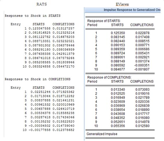

I am estimationg generalized impulse response function(Pesaran and Shin, 1998).
But I'm quite confused because the estimated results are differ from EViews.
I am attaching the code and data.
I would really apprecite your help.

Note that the RATS output is blocked by shocks and the EViews output is blocked by target variable. Once you allow for that, there appears to just be a difference in scaling of the covariance matrix. You'll have to check the EViews documentation to see how they are doing that.

I find that the different results are "d.f. adjustment" issue.
